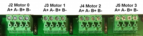

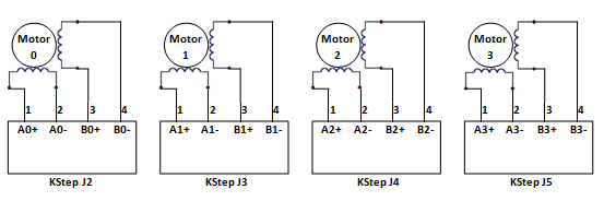

2F. Wiring Motors to KStep
Stepper motors come in a variety of wiring configurations from 4 to 8 wires. KStep only needs 4 of these to drive a stepper since KStep does not require the center tap wires. KStep requires only the full bridge coils to drive the stepper and you can ignore center tap wires if your motor has them. For 8-wire steppers, you have a choice about how to wire them, in series or in parallel and would need to choose the power supply to fit the wiring method.
There are many resources on the web that describes Stepper motor wiring so we will not address the specifics here, but essentially you need only to wire in the coils across the "+" and "-" of the motor power output of KStep.
Warning: you can damage KStep if you wire the motors incorrectly. Make sure to measure the resistance between coils and that you have identified your coils properly before wiring into KStep. It is vitally important that each coil is wired into KStep properly.
Motors can be wired into connectors J2 through J5 on KStep according to the following diagram:
In addition, take note of the following default mapping as it is useful to know for the next steps (this mapping can be altered in software):
  1. Axis Channel #0: Output Channel = 8 -> Motor Wiring J2
  2. Axis Channel #1: Output Channel = 9 -> Motor Wiring J3
  3. Axis Channel #2: Output Channel = 10 -> Motor Wiring J4
  4. Axis Channel #3: Output Channel = 11 -> Motor Wiring J5

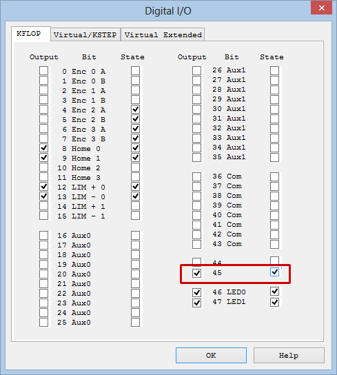

3A. Enabling Output
Once you have the voltage clamping, current limits and power supply set and wired, you are ready to begin moving your motors.
To do this, while the KStep LED D1 MOT PWR is illuminated, open KMotion.exe, select the Digital IO Screen, Set IO bit 45 as Output (enable the checkbox to the left of bit 45), Set IO 45 State to On (enable the checkbox to the right of bit 45). Verify that the KStep D3 ENABLE LED illuminates and that your motors hold position against a torque - in other words, you cannot move the motor shaft with your fingers. In this state, the motors will become warm and may become too hot to touch.
As a side note, this action can also be performed by entering the following commands in a C program or sending the commands using the Console screen:
    SetBitDirection(45,1);	//This sets the Enable Signal as Output
    SetBit(45); 		//This Enables the amplifiers
Or by an external signal wired to KStep's J6 terminal.

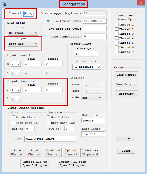

3B. Setting Axis/Channel Parameters and Running an Initialization C Program (Init)
The goal in this section is to set the parameters that will ultimately go into the Init program. To do this, you will use two screens in KMotion: "Config & Flash" and "Step Response." If you plan to use an encoder for Closed-Loop Stepper Control, you would also use the "IIR Filters" screen as well, but it is not used for open-loop stepper control as described in this tutorial. You can view an explanation of how parameters are passed to/from KFLOP/Kogna, loaded, saved and copied to C Programs here: https://dynomotion.com/Help/Parameters/index.html.
  1. In KMotion, Open the "Config & Flash" Screen and select the "Channel" at the top of the screen for the axis you plan to use (0-3).
  2. Since it is best to start with a known default, click on "Load Channel" and choose the corresponding "KStepAxis#.mot" file where # matches the chosen Channel. This will load the last saved settings in that file, which are set to default values that should work for a majority of stepper motors. In addition, loading this file puts the Channel into "Step Dir" Axis output mode, which is required for KStep.

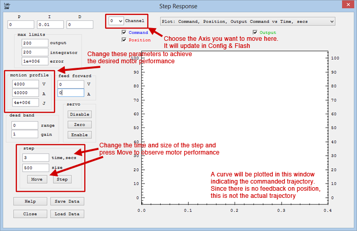

  3. After loading the Channel, open the "Step Response Screen" screen.
  4. Notice at the top that the Channel number matches the Channel number on the Configuration screen. Note: changing the Channel on either the Configuration or the Step Response screen will change the Channel in the other screen.
  5. The purpose of the Step Response screen in this tutorial is simply to help you set the Velocity, Acceleration and Jerk values to achieve smooth motor performance. These values are on the Step Response screen under "motion profile" labeled V, A and J, respectively.
  6. Click on the 'Move' button. If Channel "0" is chosen, the motor wired to the J2 terminal should move a few degrees one direction and then back to the original position and, after a few seconds, a plot will appear in the Step Response Screen showing the Commanded Step movement. You can increase the step time (up to a maximum of 3.5 seconds) and size in this screen to get a larger movement.
  7. Now you can change the V, A, and J values until you are satisfied that the motor is moving smoothly - typically keeping A to be an order of magnitude or more than V, and J to be an order of magnitude more than A. If the motor stalls, seems jerky or misses steps, you can decrease the parameters until motion is smooth. In fact, it is recommended that you increase the parameters until the motor stalls, then decrease the parameters by 30-50%. Note: motors under load will perform differently so you may need to revisit this step once your motors are carrying weight. In that case, take precautions to ensure the system is not damaged if the motor experiences a stall. Click here for a discussion on choosing values for the Velocity, Acceleration and Jerk parameters.
    The V, A, and J parameters are in terms of microsteps since KStep performs all movements using microstepping, which is 16 microsteps for every step. Therefore a Velocity value of 4,000 means 4,000 microsteps per second. You can relate this to your motor velocity by this equation:
    Motor RPM = 60 * V / (16 * Step/Rev)
    where V is the Velocity value on the Step Response screen and Step/Rev is the steps per revolution specification for your motor. For a motor with 200 steps/rev, a value of 4,000 for V equates to 75 RPM. Take note of the direction your motor spins and if you want it to spin in the opposite direction you can change the 'gain' value in the Configuration window to '-1'.
  8. As the parameters are changed, they are automatically available to the Configuration window so they may be saved, downloaded to KFLOP/Kogna, copied to the clipboard or exported to an open C program. Furthermore, the parameters for each axis are persistent in that you can select a new Channel and the parameters for the previous Channel will not be lost unless the KMotion program is closed. Because of this, when you copy to the clipboard or export to an open C program, parameters for all axes are copied or exported to the C program (as long as the axis exists in the C program as shown below).
Once the parameters are set, you can save them to a file, export them to a C program or download them to KFLOP. To do this:
  1. Save to a file: On the Config & Flash screen, click the Save Channel button and choose a file location and click Save. You can open this file later to reload those paramaters.
  2. Download to KFLOP/Kogna: On the Config & Flash screen, click the Download Channel button. This will load KFLOP/Kogna with the axis parameters.
  3. Copy to a C Program: For this you must have a C Program open with the initialization parameters within int main(). An example C Program is located in the \KMotionXXX\C Programs\KStep folder and a good program to choose is the InitKStep3Axis.c, which has parameters for, and enables, 3 axes. Then simply click the 'Export All to Open C Program' and all available channels will be merged into the open C program if channel assignments are present there. This would then become an "Init" file.
  4. Copy to Clipboard: This button simply copies the parameters to Window's Clipboard so you may paste into any other text window that you wish.

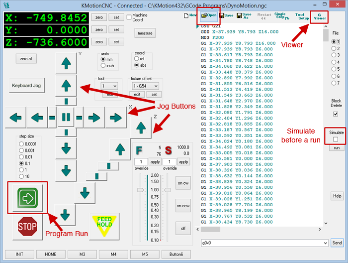

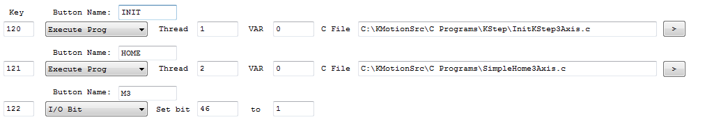

3D. Use KMotionCNC to jog your motors
After running an Init file such as InitKStep3Axis.c for initialization, you are ready to move your motors by using KMotionCNC. Try moving the motors by first clicking on the jog buttons (buttons with green arrows at left). If everything is initialized properly the motors should move when the respective jog button is clicked. These jog buttons are mapped to the axes by the "DefineCoordSystem(0,1,2,-1);" command discussed above. In this example, the X-axis is mapped to Axis #0, Y-axis is mapped to Axis #1, Z-axis is mapped to Axis #2 and the A-axis is not used. If pressing the jog buttons move the motors, then you are ready to begin running G Code. To do this, within KMotionCNC choose "Open" and choose a G Code program from the G Code Programs folder. If everything has been initialized correctly, the motors will move when the Start button is pressed to start the G Code.
Note: An initialization C program such as the InitKStep3Axis.c must be run before operating with KMotionCNC will work. This initialization C program can be called with the 'Init' button in KMotionCNC once programmed to do so by setting the file location and Thread number for the INIT button within the 'Tool Setup' Screen on the 'User Buttons' tab in KMotionCNC:
Custom Actions
The GUI of KMotionCNC can be configured based on how many axes you are using by changing the option for "Main Dialog Face" on the 'Tool/Setup Files' tab within the 'Tool Setup' screen. The screenshot below is for a 3-axis setup as you can tell from the display of only X, Y, and Z coordinates.
3-Axis Setup
Note that the motors will not yet be moving accurately until the full parameters are set within KMotionCNC. To do this, you will set the Counts per inch (Cnts/inch) for each axis on the Trajectory Planner tab within the Tool Setup screen of KMotionCNC. You should also set the axis velocities and accelerations, and jog velocities and accelerations for your system on this tab.
