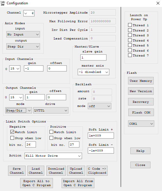

Configuration and FLASH Screen
Jump to Axis Parameters Utility Functions descriptionJump to Limit Switch Options descriptionJump to Output Channel descriptionJump to Input Channel descriptionJump to Axis Mode DescriptionJump to Flash memory descriptionJump to Launch Threads descriptionJump to Lead Compensation descriptionJump to InvDistPerCycle descriptionJump to Max Following Error descriptionJump to Microstepper Amplitude description Jump to channel selection description
(Click on above image to jump to relative topic)
The Configuration and FLASH Screen displays and allows changes to KFLOP's configuration and allows the configuration, new firmware, or user programs to be FLASH'ed to non volatile memory.
Each axis channel is configured independently. To view or make changes to a configuration first select the desired axis channel using the channel drop down. Note that changing an axis on any screen switches the active channel on all other screens simultaneously.
The parameters for each axis's configuration are grouped into three classes:Definitions, Tuning, and Filters Each class of parameters are displayed on three corresponding screens:
The Configuration Screen contains definition parameters that should be set once and remain set unless a physical change to the hardware is made. For example, a Stepper motor might be replaced with a Brushless Motor and Encoder.
The Step Response Screen contains parameters that are tuning related and are located where the tuning response is most often adjusted and checked. For example, PID (Proportional Integral Derivative) Parameters are located there.
The IIR Filter Screen contains parameters related to servo filters.

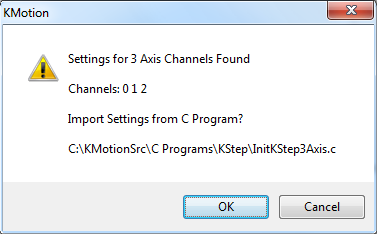

Import / Export C
To completely synchronize all the Configuration Screens (Config/Flash, Step Response, and Filters) for all axes to a C Program use the Export All to Open C Program Button. To Import all settings from a C Program select the Import All from Open C Program Button. The C program must be open on the C Program Screen. In both cases the C Program will be scannedto find blocks of axis settings and will determine which axis exist in the C Program. The results of the scan will be displayed before importing or exporting the settings. The dialog box below shows an example where 3 channels were found Select OK to proceed with the import.
Import Axes Found
Axis Modes
ConfigurationConfiguration
Use the respective dropdown to set either the axis Input or Output Mode. The input mode defines the type of position measurement (if required) for the axis. Closed loop control always requires some type of position measurement. For open loop stepper motor control, position measurement is optional.
The output mode determines how the output command should be achieved. Either by driving SnapAmp PWMs and Full Bridge Drivers to control a specific type of motor, by driving a Kanalog DAC signal that will drive an external power amplifier, or by driving Step and Direction digital outputs.
No Output mode is used when no output is required or a User Program will be writing the output to some device not directly supported (ie PWM Outputs).
Microstep mode is used with SnapAmp to apply sine/cosine currents to a stepper motor (this does not refer to driving microstepping Step Dir Drives).
DC Servo mode is used with SnapAmp to drive Brushed DC Motors.
3PH Servo mode is used with SnapAmp to drive Brushless 3 Phase Motors.
4PH Servo mode is used with SnapAmp to drive Brushless 4 Phase Motors (ie Steppers as servos).
DAC Servo mode is used with Kanalog DACs to drive Analog Amplifiers.
Step Dir mode is used with open loop Step/Direction Drives (ie KStep or other external Drives) Note KFLOP outputs "steps" to external drives and whether the drive interprets the "steps" as microsteps or full steps or servo steps are dependent on the Drive.
CL Step mode is used with Step/Direction Drives in a closed loop manner with feedback.
For External Step and Direction Outputs see Step and Direction Output Mode and Closed Loop Step/Dir Output Mode.

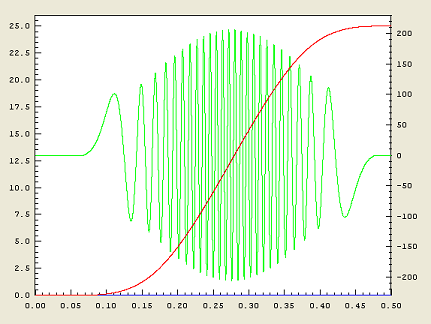

This plot above displays a simple 0.5 second motion with no Lead Compensation for a Microstepper Motor. Position axis shown on the primary (left axis) for the red plot has units of cycles. PWM output shown on the secondary (right axis) for the green plot has units of PWM counts. Move parameters are: Vel=200 cycles/sec, Accel=200 cycles/sec2, Jerk=10000 cycles/sec3. Note that regardless of velocity PWM amplitude is constant.

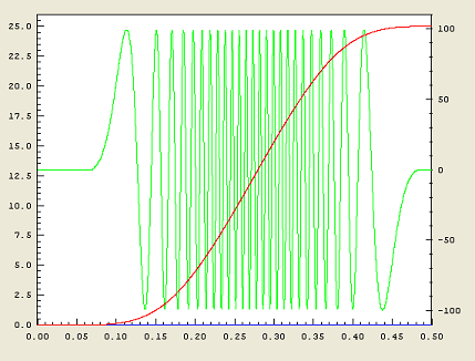

This plot displays the same 0.5 second motion with Lead Compensation = 27.0. All other parameters same as above. Note how PWM amplitude increases with velocity.
If motor parameters are unknown, a trial and error approach may be used to find the best lead compensation value. The following procedure may be used:
  1. Set Lead Compensation to zero
  2. Increase motor speed until a drop in torque is first detected
  3. Increase Lead Compensation until normal torque is restored
Setting the Lead Compensation too high should be avoided, as it may cause over current in the motor at medium speeds or voltage distortion due to saturation (clipping).

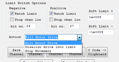

KFLOP has the ability to monitor limit switch inputs for each axis and stop motion when a physical limit switch is detected. The limit switch options allow this feature to be enabled or disabled for each limit (positive or negative), what specific bit to be monitored for each limit, what polarity of the bit indicates contact with the limit, and what action to perform when a limit is detected.
Select Watch Limit to enable limit switch monitoring.
Select Stop when low to select negative true logic for the limit (motion will be stopped when a low level is detected).
Specify a bit no. for which bit is to be monitored for the limit condition. See the Digital IO Screen for current IO bit status and a recommended bit assignment for limit switches (bits 12 through 19). If in a particular application it isn't critical to determine which Limit Switch (either positive or negative, or even which axis) the number of digital IO bits consumed by limit switches may be reduced by "wire ORing" (connecting in parallel) multiple switches together. In this case, the same bit number may be specified more than one place.
The Action drop down specifies what action should be performed when a limit is encountered.
Kill Motor Drive - will completely disable the axis whenever the limit condition is present. Note that it will not be possible to re-enable the axis (and move out of the limit) while the limit condition is still present and this mode remains to be selected.
Disallow drive into limit - will disable the axis whenever the limit condition is present and a motion is made into the direction of the limit. This mode will allow the axis to be re-enabled while inside the limit and will allow a move away from the limit.
Stop Movement - this action will keep the axis enabled, but will FeedHold the Coordinate System. This will cause commanded positions to decelerate to a stop in a controlled manner. Independent motions will decelerate to a stop in the same manner as a Jog to zero speed would cause. Coordinated Motion will decelerate all axes to a stop along the motion path.
The FeedHold mode will remain and prevent any further motion until cleared In KMotion.exe the button will flash and can be pushed to clear the Feedhold In KMotionCNC Feedhold can be cleared by pushing . If further motion is attempted into the Soft Limit another Feedhold will occur. However if no motion, or motion out of the Limit, Feedhold will remain clear and the motion will be allowed.

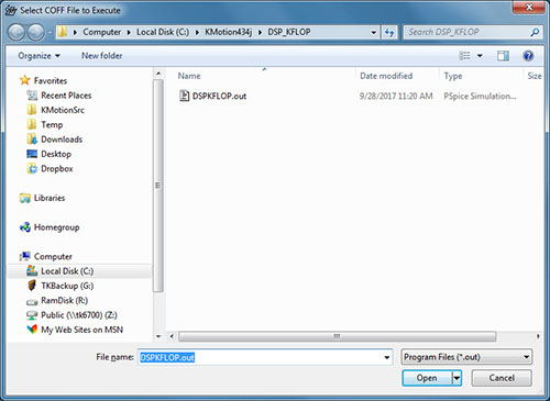

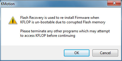

  1. Turn off KFLOP
  2. Run KMotion.exe, Config/Flash Screen, select "Recovery"
  3. Click OK (see below)
  4. Select the DSPKFLOP.out file to boot (see below)
  5. Click OK
  6. When prompted, turn on KFLOP
  7. After KFLOP boots, Flash the New Version
