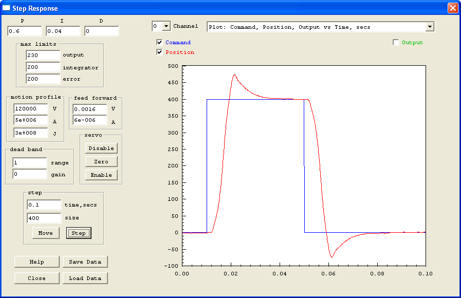

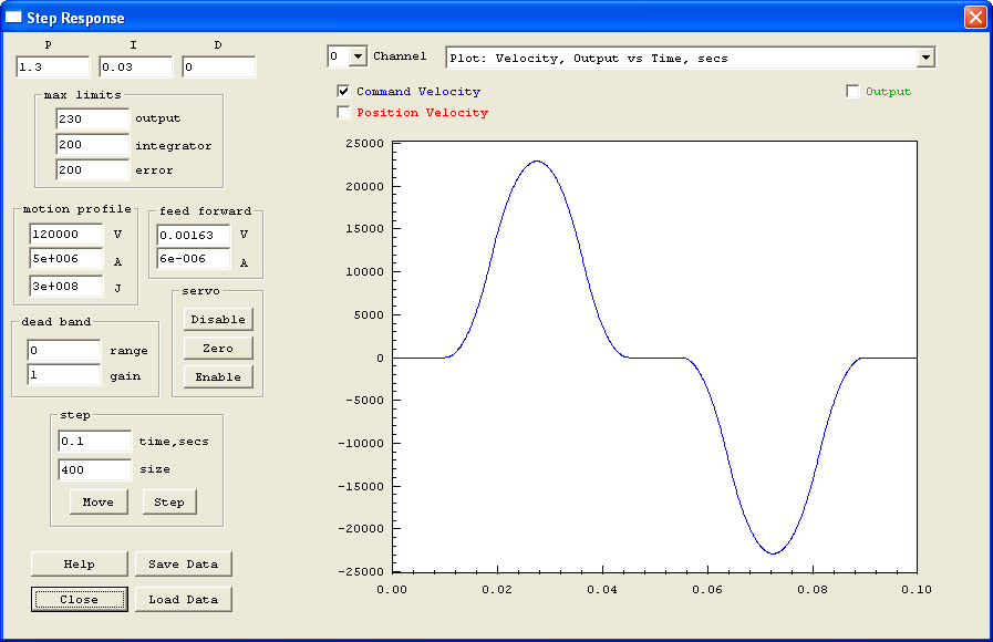

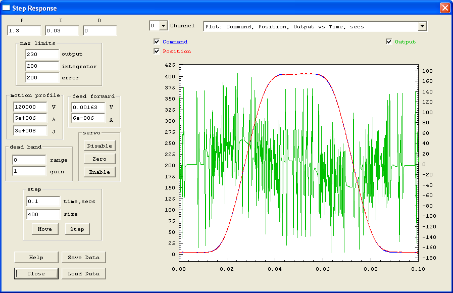

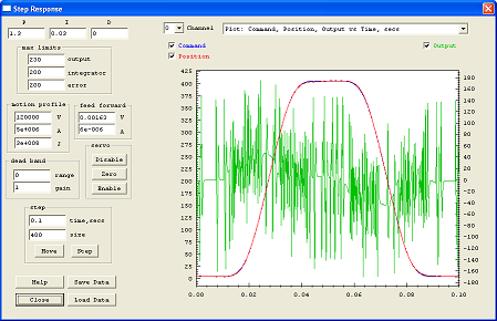

The Step Response Screen allows changes to system tuning parameters and allows measurement and graphs of the system's time response for either a Move Profile or a Step Function. The graph shown above is of an applied step function of 400 counts. The graphs shown below are of a profiled move (and back) of 400 counts. The first has the Output drive hidden and the second has the Output drive displayed. Click on the graphs for a larger view. Note that the Output drive signal contains large spikes. This is the result of quantization error in the measured position. Quantization error in the measured position makes it appear to the system as if there was no motion, and then suddenly as if there was a relatively quick motion of one count in a single servo sample cycle. This is a non-linear effect. In some cases these "spikes" may exceed the output range causing saturation a still further non-linear effect. A low pass filter may be used to "smooth" the output, see the IIR Filter Screen, but has limits. Attempting too much "smoothing" by setting a lower frequency will eventually have an effect on the performance of the system, reducing the phase margin. Normally, the cutoff frequency of the low pass filter should be significantly larger than the system bandwidth.

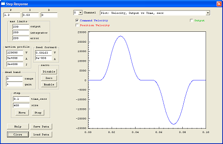

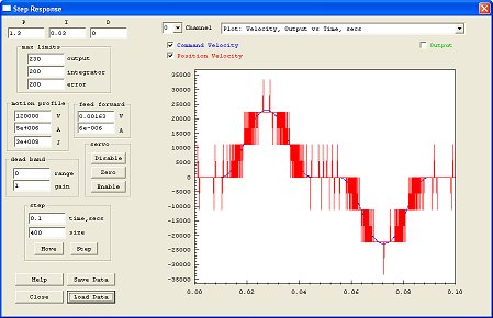

The third type of plot displays the Velocity of the Commanded and/or Measured Position. Velocity units are Position Units per second. When a Move is commanded, a motion profile is computed which achieves the motion in the shortest time without exceeding the maximum allowed velocity, acceleration, or jerk. Because the Command is a theoretical profile computed using floating point arithmetic, it is very smooth. The blue graph immediately below shows such a plot. In a velocity graph, slope in the graph represents acceleration. In this case a relatively low value specified for maximum jerk causes the changes in slope to be gradual. The second plot below is the same data but with the Measured velocity displayed along with the Commanded velocity. Because of encoder resolution limitations, measured velocity calculated using a simple position difference per sample period tends to be highly quantized as shown. In this example even at our peak velocity at ~ 23,000 position counts per second this results in a maximum of only 3 position counts per servo sample period.

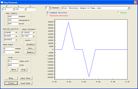

The velocity graph below, shows the effect of setting the maximum allowed jerk to a very large value (100X higher than the graph above). Note how the slope of the velocity changes abruptly which represents a high rate of change of acceleration (jerk).
