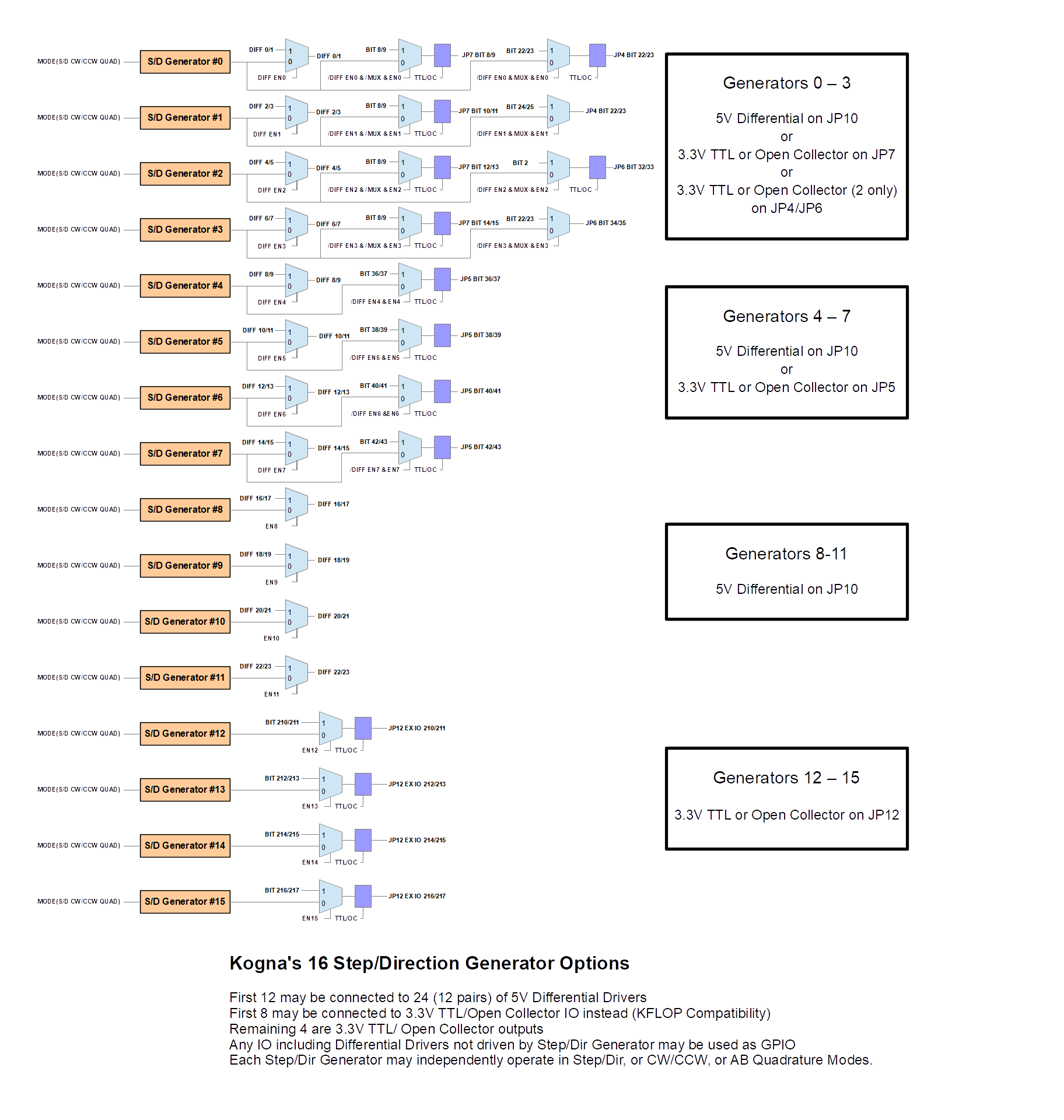

Kogna features 12 Axes of +5V Differential Drivers (24 differntial drivers to 48 connector pins). The first 8 Step/Dir Generators can be independently configured to drive a pair of differential Drivers or 3.3V KFLOP compatible pins with an 8-bit R/W FPGA Register called STEP_DIR_TO_DIFF. Each bit muxes the corresponding Step/Dir Generator. Writing a '1' to the bit will Connect the Step/Dir Generator to the differential Driver. Kogna will automatically control the corresponding Differential Enable Bits based on bit 7 of the Axis Configuration OutputChannel number so this is not normally necessary to be set by a User. For example to multiplex all 8 to differential Drivers the following C Code might be used:
FPGA(STEP_DIR_TO_DIFF) = 0xFF;
The first 8 Axes of Step/Dir outputs can also operate in a Single Ended KFLOP compatible manner where they are normally hard wired to IO bits 8 through 15 on JP7 and IO bits 36 through 43 on JP5. Additionally the first 4 Step/Dir outputs can be multiplexed to connectors JP4 and JP6 if desired. This may be required if JP7 is used for some other purpose such as interfacing to the Kanalog IO Expander. A global multiplexing bit is used to switch the outputs to the alternate connectors.
Note that the first 8 of 10 IO pins of Aux #0 and Aux #1 have internal 150 Ohm pull down resistors. Therefore Pins JP4-13, JP4-14, JP6-13 and JP6-14 may not be used in Open Collector mode.

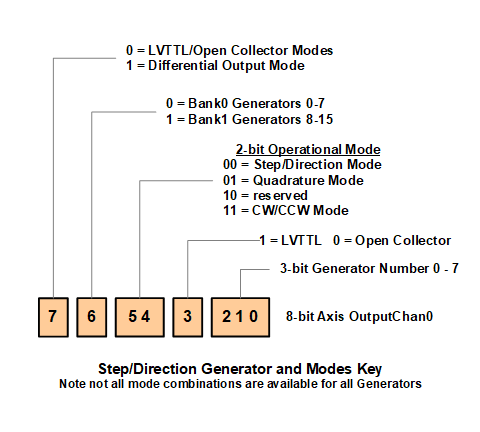

Axis output channel settings 0-255 are allowed for Kogna. Although only 16 Step and Direction generators are available for Kogna. By adding specific constants to the channel number the operation mode and output mode of each Step/Dir Generator can be changed independently. Not all Output Drive modes are valid for all Generators.
Adding 8 to the channel number uses the same generator to be used except the output pins are actively driven (high and low) as 3.3V LVTTL signals instead of only driven low as open collector outputs.
Adding 16 to the channel number switches the generator from Step/Dir to Quadrature output mode.
Adding 48 to the channel number switches the generator from Step/Dir to CW/CCW output mode.
Adding 64 to the channel number switches to the second bank of 8 generators (this is to maintain legacy compatibility with KFLOP's channel 8 Axes numbering scheme)
Adding 128 to the channel number selects Differntial Output mode and pins (only available on Generators 0-11)
Step/Dir Generators 8-11 will always drive diffential Drivers 16-23 whenever they are enabled.
Any IO pin not being driven by a Step/Dir Generator may be used for other purposes such as GPIO.
If an axis channel is selected as a Step and Direction axis and enabled, the corresponding 2 output pins will be automatically configured as outputs (if necessary) and they may not be used as general purpose IO.
See diagram below. For a larger image click here.
The tables below lists the IO Bit and Pin numbers associated with the Step/Dir Generator and the Mode and Multiplex option:
Generators 0-3 have 3 options:
| Enable Diff = 1 | Enable Diff = 0 | |||||
| Mux = X | Mux = 0 | Mux = 1 | ||||
| Signal | IO Bit | Pins | IO Bit | Pin | IO Bit | Pin |
| Step 0 | 250 | JP10 - 1 & 2 | 8 | JP7 - 15 | 22 | JP4 - 13 |
| Direction 0 | 251 | JP10 - 3 & 4 | 9 | JP7 - 16 | 23 | JP4 - 14 |
| Step 1 | 252 | JP10 - 5 & 6 | 10 | JP7 - 17 | 24 | JP4 - 15 |
| Direction 1 | 253 | JP10 - 7 & 8 | 11 | JP7 - 18 | 25 | JP4 - 16 |
| Step 2 | 254 | 12 | JP7 - 19 | 32 | JP6 - 13 | |
| Direction 2 | 255 | 13 | JP7 - 25 | 33 | JP6 - 14 | |
| Step 3 | 256 | 14 | JP7 - 21 | 34 | JP6 - 15 | |
| Direction 3 | 257 | 15 | JP7 - 22 | 35 | JP6 - 16 | |
Generators 4-7 have 2 options:
| Step 4 | 258 | 36 | JP5 - 1 | |
| Direction 4 | 259 | 37 | JP5 - 2 | |
| Step 5 | 260 | 38 | JP5 - 3 | |
| Direction 5 | 261 | 39 | JP5 - 4 | |
| Step 6 | 262 | 40 | JP5 - 5 | |
| Direction 6 | 263 | 41 | JP5 - 6 | |
| Step 7 | 264 | 42 | JP5 - 7 | |
| Direction 7 | 265 | 43 | JP5 - 8 | |
Generators 8-11 are Differential only:
| Step 8 | 266 | JP14 - 9 & 10 |
| Direction 8 | 267 | JP14 - 11 & 12 |
| Step 9 | 268 | JP14 - 13 & 14 |
| Direction 9 | 269 | JP14 - 15 & 16 |
| Step 10 | 270 | JP14 - 17 & 18 |
| Direction 10 | 271 | |
| Step 11 | 272 | |
| Direction 11 | 273 |
Generators 11-15 3.3V IO only:
| Signal | IO Bit | Pin |
| Step 12 | 200 | JP12 - 11 |
| Direction 12 | 201 | JP11 - 12 |
| Step 13 | 202 | JP12 - 13 |
| Direction 13 | 203 | JP12 - 14 |
| Step 14 | 204 | JP12 - 15 |
| Direction 14 | 205 | JP12 - 16 |
| Step 15 | 206 | JP12 - 17 |
| Direction 15 | 207 | JP12 - 18 |

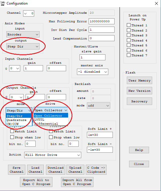

The simplest method to configure a Step/Dir Axis and its various channels and modes is to use the KMotion.exe Configuration Screen shown below. To configure an axis as step and direction, on the Configuration Screen select output mode as "Step Dir" and select which of the 16 available Step and Direction generators should be used by setting the appropriate Output Channel 0 setting. Also select the appropriate operational mode and output Drive mode. See below.

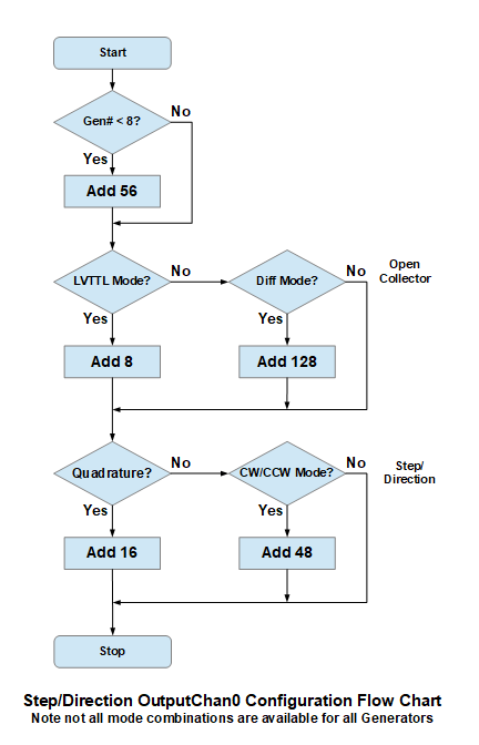

The table below summarizes the Output Channel Number to specify to select the desired Generator and Mode:
| Step/Dir mode +0 | Quadrature mode +16 | CW/CCW mode +48 | |||||||
| Generator | Differential +128 |
Open Collector +0 |
LVTTL +8 |
Differential +128 |
Open Collector +0 |
LVTTL +8 |
Differential +128 |
Open Collector +0 |
LVTTL +8 |
| 0 | 128 | 0 | 8 | 144 | 16 | 24 | 176 | 48 | 56 |
| 1 | 129 | 1 | 9 | 145 | 17 | 25 | 177 | 49 | 57 |
| 2 | 130 | 2 | 10 | 146 | 18 | 26 | 178 | 50 | 58 |
| 3 | 131 | 3 | 11 | 147 | 19 | 27 | 179 | 51 | 59 |
| 4 | 132 | 4 | 12 | 148 | 20 | 28 | 180 | 52 | 60 |
| 5 | 133 | 5 | 13 | 149 | 21 | 29 | 181 | 53 | 61 |
| 6 | 134 | 6 | 14 | 150 | 22 | 30 | 182 | 54 | 62 |
| 7 | 135 | 7 | 15 | 151 | 23 | 31 | 183 | 55 | 63 |
| 8 | 192 | 64 | 72 | 208 | 80 | 88 | 240 | 112 | 120 |
| 9 | 193 | 65 | 73 | 209 | 81 | 89 | 241 | 113 | 121 |
| 10 | 194 | 66 | 74 | 210 | 82 | 90 | 242 | 114 | 122 |
| 11 | 195 | 67 | 75 | 211 | 83 | 91 | 243 | 115 | 123 |
| 12 | N/A | 68 | 76 | N/A | 84 | 92 | N/A | 116 | 124 |
| 13 | N/A | 69 | 77 | N/A | 85 | 93 | N/A | 117 | 125 |
| 14 | N/A | 71 | 78 | N/A | 86 | 94 | N/A | 118 | 126 |
| 15 | N/A | 71 | 79 | N/A | 87 | 95 | N/A | 119 | 127 |
For a table mapping from Output Channel Number to Generator and mode see here.

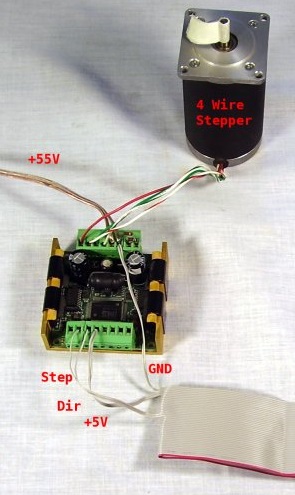

Example Configuration for a IM804 Amplifier and Rapidsyn Stepper
Layout - KMotion - Amplifier - Motor
Amplifier Connections - resistors set coil currents (1500 ohms = 3A) and idle standby current (270 ohms = 0.5A). DIP Switches set to ON-OFF-OFF-ON for 128:1 micro-stepping.
Rapidsyn stepper motor. Note coil winding's centertaps are not used.
Axis channel 0 configures as "Step Dir" mode and using Step and Direction generator 0.
Max Velocity 1.6 x 106 steps/sec (1.6e6 / 128 = 12,500 sps = 3750 RPM). Note this (and most) steppers lose most all of their useful torque above several thousand full steps per second. The high speed demonstrated here is intended to demonstrate KMotion's ability to generate high pulse rates.
Max Acceleration 6 x 106 steps/sec2.
Max Jerk 2 x 108 steps/sec3.
1 x 106 count Move performed and data captured over 3 seconds.
Pushing Move downloads all parameters, enables the axis, performs the movement, and plots the result.
Note after the axis has been enabled, digital IO bits 8 and 9 have automatically been configured as outputs for use by Step and Direction Generator #0.
