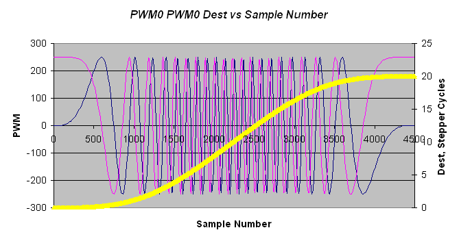

The following example shows how to setup to capture the two PWM drives (for a stepper motor) and the commaned destination for a 0.5 second time period, trigger the capture, make a simple move, wait until the capture is complete, and print the results.

An Excel plot of the captured data is shown below.
Gather Example Plot
