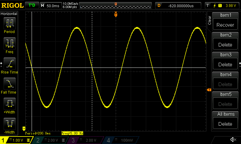

Analog Oscilloscope traces of Analog signals generated by a KFLOP/Kogna Software generated PWM Signal controlling two optically isolated Konnect Outputs that are then passed through a simple low pass filter.
High resolution and response rates easily usable for speed control applications
SineWave

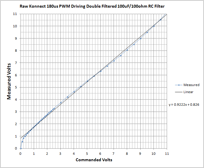

Reasonable linearity. This would require calibration if higher accuracy is needed.
LinearityChart

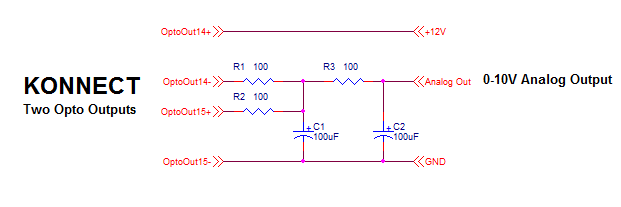

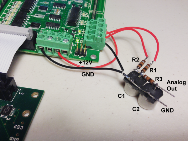

Circuit
Simple cascaded dual low pass filters. Only 5 components. One resistor type and one capacitor type. Component values are not critical (R1 and R2 should be matched).
One Konnect Output charges the capacitors and one output discharges them. Both should not be turned on simultaneously (but no damage will occur if they are as R1+R2 will limit the current).
The relatively low resistance values (100 Ohms) provides low output impedance so that any connected load should have a minimal effect. A load of 10Kohms or higher should work well.
Double filtering provides low output ripple, while still having relatively quick response to changes, uses reasonably small capacitors, even with relatively low PWM rates.
Konnect Outputs can be updated every 180us. So 180us is the basic PWM quantum. This results in ~ 10mV p-p ripple.
LowPassCircuit
WiredCircuit
CircuitTop
