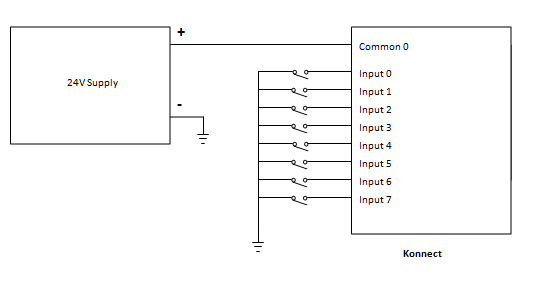

Konnect's 32 optically isolated inputs are grouped into 4 independent Banks of 8 inputs. This allows any Bank to be used with either sourcing or sinking signals. However all inputs in the same bank share the same common and must operate in the same mode. The 4 independent Banks also allow different supply voltages and supply isolation to be used for each Bank. 24V is the preferred input voltage and will draw (24V - 1.4 - 1.4)/4K ~5ma of current.
Konnect's 32 optically isolated inputs can be driven from a +/- 4.75V to a +/-25V signal. Less than 2V should be applied to ensure the input is off. One of the 32 input circuits is shown below. The input consists of a AC type of Optocoupler in series with an LED indicator in series with a 4Kohm resistor. The AC type of input allows the common to be connected to either the Positive or Negative Supply voltage so that either sinking or sourcing outputs can be used (current can flow either direction to activate the input).
External Wiring would typically be arranged such as:

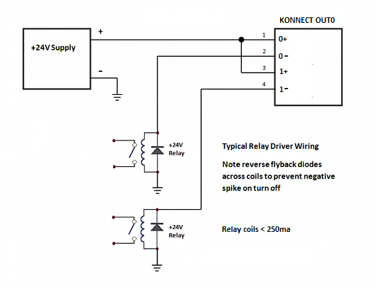

Each of the 16 Optically Isolated Outputs is completely isolated with a + and - terminal. When active the output passes current from the + to - terminals much like a relay contact would.
The Outputs are capable of driving medium power devices such as relay coils. Loads up to 30V @ 250ma may be driven.
The internal Konnect Output Circuitry is shown below which converts a photo transistor output to darlington transistor output. The 220Ohm resistor allows the output have a low on voltage for low currents before the transistor turns on. This allows the output to drive low current circuits with a smaller on voltage (2ma @ < 0.6V). For example LVTTL/TTL inputs require less than 0.8V to guarantee a low input. At higher currents Q1 becomes active and keeps the on voltage drop below 0.9V at 0.25A. Switching 0.25A at 24V allows loads up to 6W to be driven.
A typical wiring diagram driving 24V relays. Because of the less than 0.9V drop on the Konnect outputs the load will be driven with more than 23.1V.
