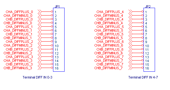

JP1/JP2 Differential Inputs
16 Differential Receiver Inputs are provided. Kanalog converts the differential signals to signal ended LVTTL signals and passes them through to existing KFLOP/Kogna IO pins.
JP1 converts 8 of the signals and connects them to KFLOP/Kogna IO bits 0-7 (Kflop JP7 Pins 7-14) which are KFLOP's/Kogna's 4 encoder A/B input channels.
JP2 converts 8 of the signals and connects them to KFLOP/Kogna IO bits 36-43 (Kflop JP5 Pins 1-8) which are General Purpose IO pins.
Typically up to 4 encoder's A/B signals are connected to JP1 and any Z index inputs are connected to JP2.
These differential inputs are moderately damped with an internal 470ohm resistor connected across the + to - inputs. If additional termination is required an external resistor may be connected.
JP1JP2

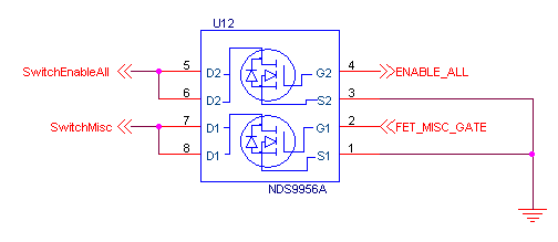

JP8 - FET Switch Outputs (relay drivers) - watchdog - power outputs
(8) 24V @ 1Amp relay FET Switch Outputs are available on Kanalog mapped as Output Bits 152-159. When activated (checked on or with state "1") the FET Switches make a connection to ground. Normally a load, such as a relay coil is connected between some appropriate +supply and a Switch input. Therefore when the Switch makes a connection to ground, the load is energized.
Caution! Inductive loads MUST have a reverse diode connected in parallel with the load to avoid a high voltage spark when the switch opens. Failure to allow a re-circulating current path on any inductive coil such as a relay, solenoid, or motor is likely to cause permanent damage.
One Enable or Watchdog FET Switch Output is also available (24V @ 1Amp). This switch conducts after KFLOP/Kogna boots, enables the +/-15V generator, and begins communicating with the board. It is recommended that this switch output is used an one of the conditions to enable main system power for motors and other devices.

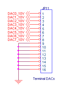

JP11 - Analog Ouputs +/- 10V
(8) +/- 10V analog ouputs are provided. These are mapped and referenced as DAC outputs 0-7 for KFLOP/Kogna configuration purposes. Output impedance is approximately 2K ohms.
(8) ground terminals are provided. Kanalog contains a single solid ground plane so these grounds may be used as any digital or analog ground connection.
JP11

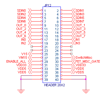

JP12 - General Purpose Inputs, Outputs, Low level analog in, Supplies
JP12 is a standard 40 pin IDC header connector.
(8) 3.3V LVTTL Inputs are provided (SDIN0 - SDIN7) mapped as Kanalog Input bits #128-135. Inputs are diode clamped to 3.3V.
Note: To connect 5V signals a 200ohm external series resistor is required
(8) 3.3V LVTTL Outputs are provided (OUT 0 - OUT_7) mapped as Kanalog Output bits #160-167.
ADC channels 0-3 have internal low voltage inputs exposed as signals IN0-IN3. Instead of driving the normal terminal inputs with a voltage range of +/- 10V. The INx pins may be driven with low voltage (0V - 3V) signals with an input impedance of ~10K ohms. This may allow higher resolution with low voltage signals. Caution should be used as these are low voltage unprotected signal inputs.
+/- 15V from the internal DC-DC generator is available on pins V15 (+15V) and VM15 (-15V). 70ma is avai lable for external use for each supply.
ENABLE_ALL is the LVTTL equivalent of the SwitchEnableAll FET output if a logic level is desired instead of the FET SWITCH output.
One additional 24V 1Amp FET switch is available with an exposed gate. Drive signal FET_MISC_GATE to 3.3v to turn on the FET (SwitchMisc) output.
SwitchMisc
+3.3V and +5V are available on this connector. +3.3V is available as an output only (regulated down from the +5V). +5V is common to all other +5V signals and may be used as input or output.
JP12

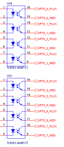

JP13 - Opto Outputs
(8) totally isolated and independent optically isolated outputs are provided.
Opto output transistors are rated for a max voltage of 80V and will conduct up to 25ma of current.
OptoOutCircuit
JP13

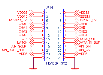

JP14 - KFLOP/Kogna
This is the main connection between KFLOP/Kogna and Kanalog and should consist of a short 26-pin one-one ribbon cable.
Analog and digital data passes through this cable in serial form. The first 8 differential signals pass to the KFLOP/Kogna in parallel form.
None of these signals should be used by the User.
JP14
JP15 - Opto Inputs
(8) totaly isolated and independent optically isolated inputs are provided.
Input LEDs have a series resistance of 10Kohms and may be driven directly by any voltage from 5-24V. Max drain of 2.4ma when driven with 24V.
JP15
