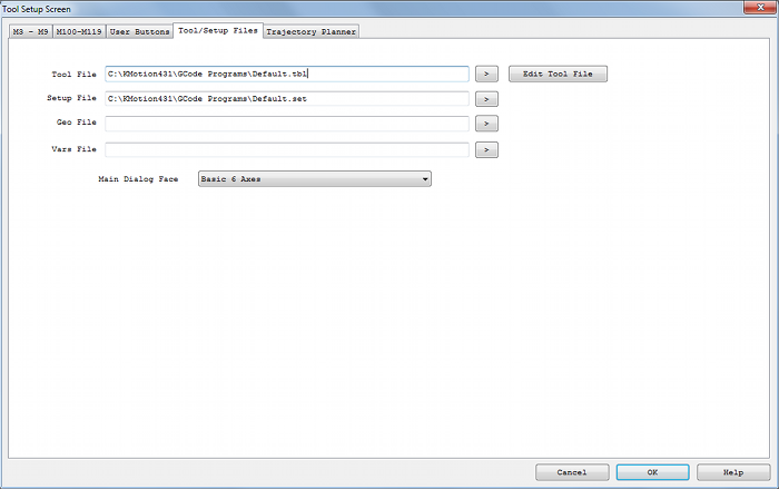

Tool Setup Screen - Files & Main Dialog Face
Tool Setup Files
(Click on image to jump to related help)
The Tool Setup Screen allows KMotionCNC to be configured for a particular machine tool. Each machine tool is likely to have different motion resolution, speeds, and acceleration limits. It is also likely to have different IO requirements with regard to Spindle control and such. Additionally a machine may have different initialization and homing requirements. KMotionCNC has a flexible mechanism for defining what type of action is to be performed for various M Codes and Custom Buttons. See here how to password-protect these parameters.
Tool Table File
Tool Table File
The Tool Table File specifies the disk text file which contains the table of tool definitions. In some cases the G Code Interpreter needs to know the length and diameter of the selected tool for tool path compensation. This file is used to define up to 99 tools. See also Selecting Tools.

Setup File
Setup File
The Setup File specifies the disk text file which contains the setup table for the G Code Interpreter. In some machine tools the Interpreter may require a special initialization state. Below is the default Setup file. Modifications to the setup file should not normally be required.

Geo File
Geo File
Geometric correction file. Allows correcting errors in the the x,y,z positions. The callibration procedure involves moving the tool tip to an xy array of positions. For example, a precision grid might be printed on a glass or Mylar plate. By Jogging the tool tip to each row and column grid point and recording the machine's x,y,z position, a table of machine coordinates that correspond to perfect coordinates may be obtained. The "measure" button on the main KMotionCNC Screen may be used to log these positions. If such a table is specified here, the system will correct machine coordinates by bilinear xy interpolation of this table. Z is corrected for flatness at the plane of z=0 only.

Vars File
Vars File
The Vars File is used to save all the G Code Variables which contain Fixture Offsets as well as other values. When Variables are saved to disk the file must already exist which lists which variables are to be saved. The file is read and all the variables present in the file will be replaced with their current values. Variables 5221-5226 contain the XYZABC coordinates of the first fixture offset. Skip 20 for each successive fixture.

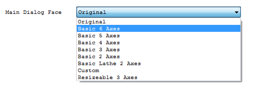

Main Dialog Face
Main Dialog Face
The Main Dialog Face selection selects the look of the main operation screen for KMotionCNC. Currently there are several available selections. The main difference is the number of axes, DROs and jog buttons. It is also possible to alter the dialogs by using a WindowsTM Resource Editor in Microsoft Visual Studio.
By selecting “Custom”, users can load cusom screen script files which can be created and modified using the KMotionCNC Screen Editor.
