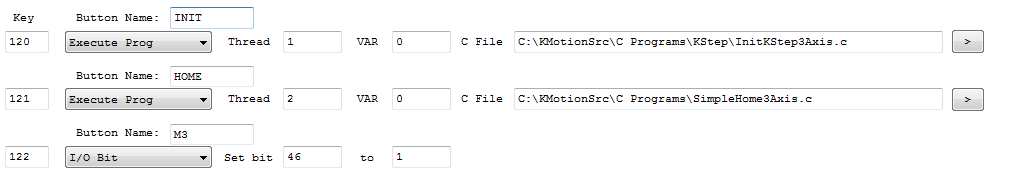

Custom Buttons
Custom Button Actions function in exactly the same manner as the G Code Actions described on the M3-M9 Tab with the only difference being that they are invoked by the User pushing a button rather than by a command encountered within a G Code Program. There is an additional Parameter above the Action Type which is the Title to be placed on the Custom Button. The example above shows buttons defined with titles "INIT", "HOME", and "M3". Up to 10 buttons may be defined. Common uses for the Buttons are to invoke programs that initialize and/or home the machine. Any Button with an empty title field will cause the button to be hidden on the main KMotionCNC screen. See here for how these defined buttons will appear in the main KMotionCNC Screen.
A Hot Key can also be assigned so that pushing that specific Key will triger the Action as if the button was clicked with the mouse. The Screen must have focus for the Hot Key to work. See below for a list of numeric Virtual Key Codes:
