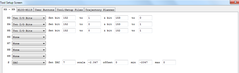

For the most basic cases where only one or two control IO bits are required for On/Off/Direction the IO operations can be configured directly. If Speed can be controlled by simple open loop scaling/limiting of a DAC output then speed control can also be configured directly.

Basic Configuration
For basic configurations where the spindle CW/CCW/OFF can be controlled with one or two IO bits (normally Kanalog Relay Driver or Opto Outputs) and with speed control from a Kanalog DAC then no C programming is required. An example configuration is shown below. Note the S action is mapped to Kanalog DAC #7 with a negative scale of -2.047. Kanalog DAC outputs are inverting such that negative DAC counts result in a positive voltage. The assumption in this case is that an S value of 1000RPM would correspond to -2047 DAC counts or +10V. And the allowed range is from -2047 to 0 counts (0V to +10V).
An additional advantage to using IO bits rather than C Programs is that they IO commands will be embedded within the motion stream and will occur synchronously with the motion and without any pause in the motion. This is especially useful for faster systems with Lasers/Engravers/Extruders instead of a traditional Spindle. For more information on buffered IO commands see here.
Tool Setup Screen

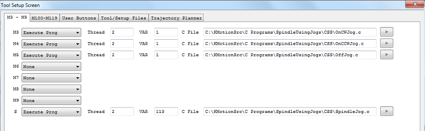

User Program Configuration
For more advanced functionality User C Programs may be assigned for each of the spindle actions. For systems that have a spindle that can be controlled with an axis channel the C Programs listed below can be used directly with little or no modification. Note if your Spindle speed is controlled by a DAC an Axis channel can be configured to output open loop to a DAC, see here for how. This assumes that axis channel has already been configured much like the other axes in the system and can be moved using Axis Jog Commands. Spindles such as this are types that can be driven like a servo with feedback, or as an open loop Step/Dir drive. The only requirement is that a KFLOP axis channel can be used for control. This also allows acceleration (and Jerk) to be controlled by the axis channel for smooth speed changes.
The example configuration below shows the four spindle tasks assigned to four C programs. Each of the programs run temporarily to perform their function and should never execute concurrently so each can use the same Thread. See here for more information on Threads. M3, M4, and M5 do not pass any parameter so the VAR should be assigned to ay unused Variable such as #1. For S the speed value is passed in the VAR parameter. If G96/G97 CSS is to be used then the same VAR should be used as the G96 speed is passed. This VAR number is defined in PC-DSP.h as

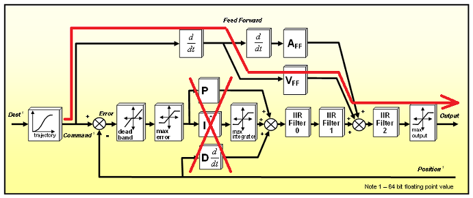

Configuring an Axis to Control a DAC open Loop
For Spindles that are controlled open loop with a 0-10V signal it is possible to configure an Axis Channel to output current Speed directly to a DAC. There a several advantages to configuring in this manner. First, the Spindle can be controlled using Jog Speed Commands in exactly the same manner as a closed loop servo (or any other) type of Axis Channel. And second the Axis Motion Profile Parameters (Acceleration and Jerk) can be used to ramp the speed up and down.
The configuration is the same as a DAC Servo with no Feedback (PID all zero) and with Velocity Feed Forward. The Servo diagram shows how the Motion Profile can be routed directly o the output using the Velocity Feedforward path:
Servo Flow Diagram

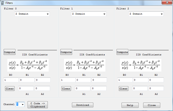

Filters all cleared to have Flat DC Gain=1
Open Loop - No Filters

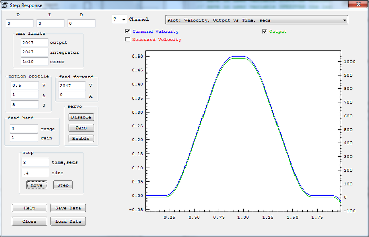

PID Zero, Max Output = full DAC Range of 2047 counts, Max Error Infinity, Feed Forward 2047 so that a velocity of 1 count/sec will generate full dac output.
Acceleration = 1 count/s2 so that full speed will ramp up in 1 second, Jerk=5 counts/s3 (Acceleration is "smoothed" over 1/5th second). This demonstration Move profile moves at 0.5 counts/sec which results in half of the full DAC output range (1023 counts or 5V analog). Note the output (green plot) follows the Commanded Velocity (blue) in perfect proportion. Any Velocity Range could be used because this is only a theoretical velocity profile and can be scaled to any proportion by the Velocity FeedForward. 1.0 counts/s is used to keep the math simple and to allow Jogging continuously for years without exceeding the Max error or Max Following Error limits.
Open Loop DAC Step Response
