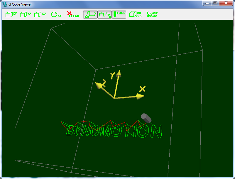

The G Code Viewer Screen displays the 3D motions of the machine tool as a G Code program is executing. To Display an entire G Code Program quickly without any physical motion of the machine tool, select Simulate on the main KMotionCNC Screen and execute the program. Linear and Circular Feed Motions (G1, G2, G3) are displayed as green paths. Rapid Motions (G0) are displayed as red lines. Note that the cursors slows after three seconds and switches to fine resolution mode for added accuracy.
Click and drag the left mouse button to translate up/down/left/right.
Click and drag the right mouse button to translate closer or farther.
Click and drag both mouse buttons to rotate.
Use the scrolllwheel to zoom.
