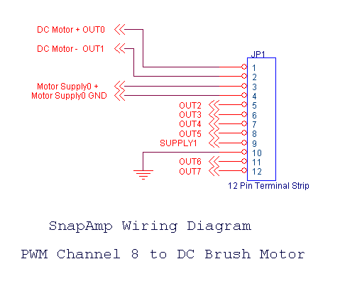

This example configuration shows a single dc brush motor connected to the first of 4 available full bridge drivers on a single SnapAmp 1000. A single-ended encoder is connected to KMotion's JP3 connector as encoder input #0 for Servo feedback. (The KMotion board is hidden underneath the SnapAmp in the photo). Note: Encoders typically come as one of two types - differential outputs (having A+, A-, B+, B-) or single ended outputs (A B). A differential encoder may be used as a single ended encoder by only using the A+ and B+ signals (and leaving the A- and B- unconnected). However single ended signals are more susceptible to noise than differential signals. KMotion has 4 single ended encoder inputs. SnapAmp 1000 has 4 differential encoder inputs. In this example a KMotion single-ended encoder input is used. Some encoders have a index pulse that occurs once per revolution usually labeled as channel Z. In this example the index is not used and is not connected.

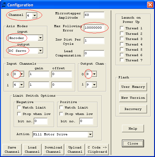

On the Configuration screen Axis Channel 4 is selected, the input type is set to Encoder at encoder channel 0, the output type is set to DC Servo at PWM channel 8, and a very large following error is set.

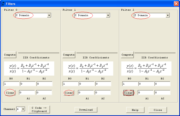

On the Filters Screen all filters are disabled by "Clearing" all filters to have a gain of 1.
Filters off

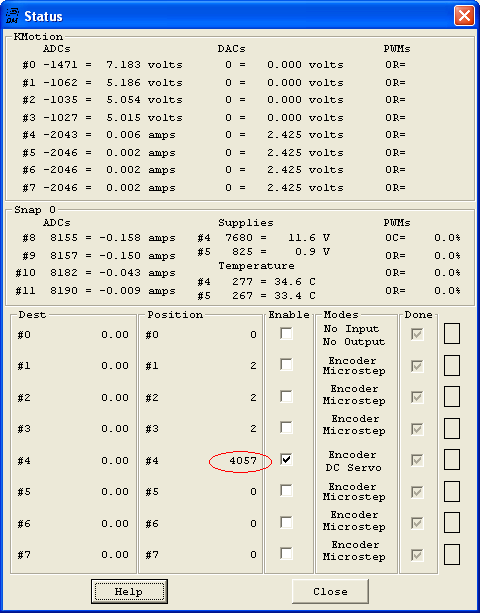

We can now rotate the motor/encoder shaft by hand and should observe counts on Axis Channel 4 on the Analog Status Screen. Note if one of the other axis's configurations also is defined as input Encoder channel 0 then that axis may count as well. The default configuration for axis 0 is Encoder input from channel 0. To avoid confusion, disable any other axis by selecting that axis, define the input/output types as "No Input" and "No Output", then download, then disable the axis. To test the encoder, rotate the encoder and check if the expected number of counts per rev are obtained. Rotating the axis the opposite direction should count in the opposite direction.

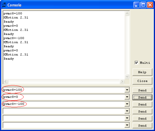

In order to test the Motor Amplifier functionality Console commands (PWMC - Pulse-Width-Modulation Current Mode) will be entered to drive the motor in the forward and reverse direction. The axis should and must be disabled to issue these commands, otherwise they will be immediately overwritten with servo output commands. Small values should be used initially. Note: PWMC commands may only be used with a SnapAmp (Software Version 2.31 or later), the KMotion onboard amplifiers do not have current feedback mode so PWM commands should be used instead. SnapAmps's PWMC current commands range from -1000 to +1000 which corresponds to approximately -30Amps to +30 Amps. So a value such as 100 might be used to provide a drive of 3 Amps.

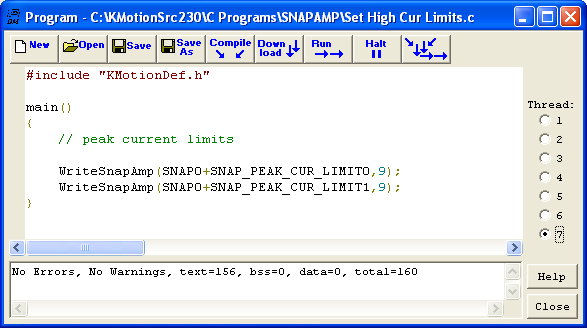

Before issuing the PWMC commands, SnapAmp's peak current fault levels should be set. After verifying that the axis is disabled (on the Analog Status Screen), load and execute the following program to set the peak current limits. The Fault Green LED on the SnapAmp should turn off. The "I'm alive" Green LED should remain blinking.
Set High Current Limits
Setup the Console Screen as shown below. Sending the commands should drive the motor in one direction, then no motor drive, then drive in the other direction respectively.
Console PWMC

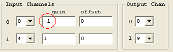

If the servo has positive instead of negative feedback, something should be reversed. Either the Motor leads may be reversed, the encoder signals may be reversed, or a Input Gain of -1 may be entered on the Configuration Screen (as shown below).

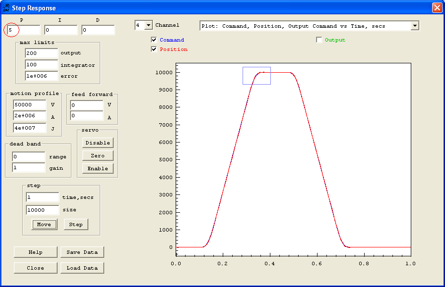

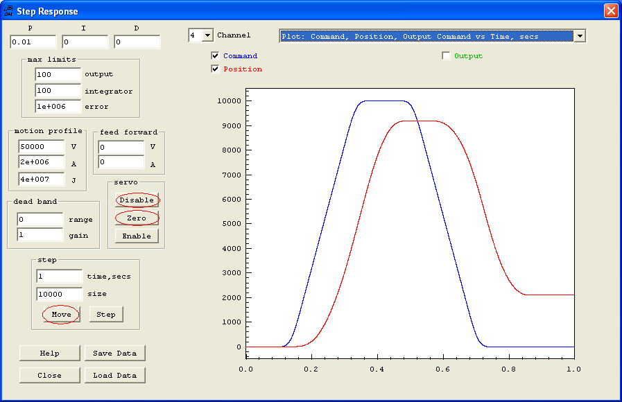

To test the current performance, disable the axis, manually move it to a position where it may move +10000 counts, then push the "Move" button. A plot such as that shown below should be observed. Set the plot type and axis selections to agree with those shown below. The blue plot is the desired path as defined by the motion profile and the motion is made for 10,000 counts and then a second motion is made back to zero. The red plot is the measured encoder position. Note that the red plot attempts to follow the blue plot but with a large error of thousands of counts. Gradually increase the P gain (possibly by factors of 2) while pushing the Move button and the following error should reduce. At some point the system will probably go into oscillation and become unstable. It may be necessary to disable the axis, reduce the gain, and re-enable the axis.
Poor Plot
Increasing the gain 500X (from 0.01 to 5) results in a much better response. Notice the blue (desired) plot is almost completely hidden behind the red measured plot. However by zooming in to the purple rectangle (left click mouse drag) we can see oscillation. See the second plot below.
Better Plot
Oscillation

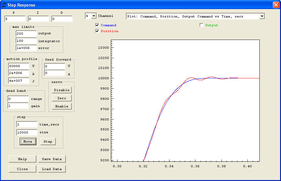

Increasing the derivative gain can often reduce oscillation. In the plot below we have set the D gain to 16. Notice the oscillation has been reduced.
Derivative Gain

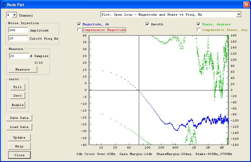

A Bode plot is useful in understanding the frequency response and for designing advanced servo loop filters. Below is the Bode plot response of the system. Important features to look for in a Bode plot is where the Magnitude (blue plot) first passes through the 0 db line. This is the bandwidth of the system. Another important measure is the "phase margin" which is how far away the phase is from -180 degrees when the magnitude is at 0db. In this case the phase margin is 28 degrees. See the Bode Screen in the main Help section for more information
Bode Plot 65Hz

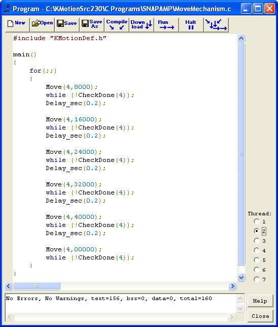

The C program below is an example of a simple program to perform a sequence of moves and repeat. There are 5 moves of 8000 counts (2 motor revs) and then a move back to the start. After each small move there is a wait until the motion is complete followed by a 0.2 second delay. Here is a video of the mechanism executing the motion.
Move Mechanism
