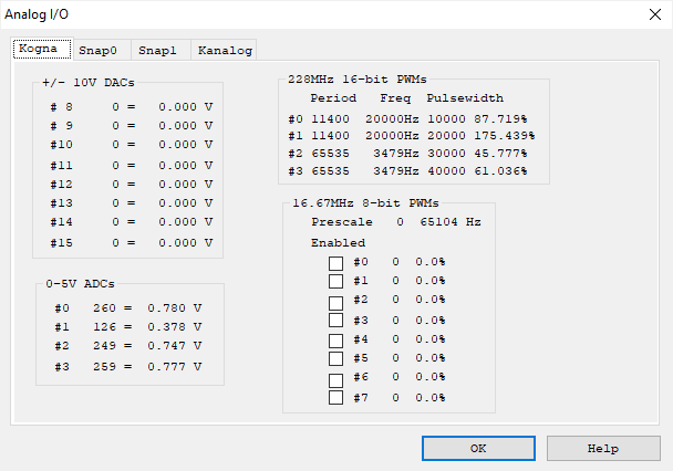

Analog IO Status Screen
The Analog IO Status Screen displays various analog measurements and commands including:
- Kogna DAC Settings
- Kogna ADC Readings
- Kogna Hi-Res PWM Settings
- Kogna PWM Settings
- Kanalog DAC Settings
- Kanalog ADC Readings
- SnapAmp Measured current flow per motor coil
- SnapAmp Power Supply Voltages
- SnapAmp Mosfet Temperatures
- SnapAmp PWM power amp settings
See links below for:
If one or two SnapAmp option boards are installed and checked on the option menu, tabs will allow display of SnapAmp Status. Current measurement for each full bridge (motor coil), Power supply voltage for each side, Temperature of each side, and PWM setting for each PWM. If Kanalog is installed and checked on the option menu a tab will allow displaying Kanalog Analog Status.
